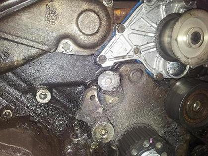

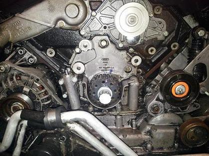

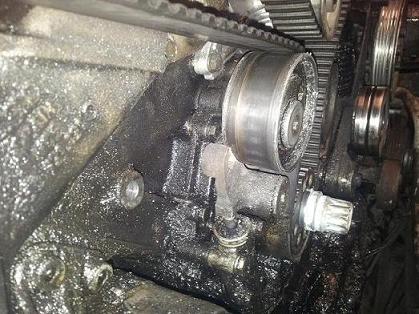

UTRHNULA SE CHYBA HYDRAULICKÉHO NAPÍNÁKU VŠECKO JSEM ZARISKOVAL JAK NA 4 VÁLCI ALE NIKDE SE MŮJ ZNÁMY KTERÝ TO DĚLAL NEDOČETL ŽE JE TŘEBA ZAARETOVAT TEN HYDRAULICKÝ NAPÍNÁK FOTKY PŘILOŽÍM POZDĚJI ABY JSTE SE POKOCHALI UKROUTILA SE NAPÍNACÍ KLADKA ZÁVIT Z NAPÍNAČKY ZŮSTAL ZAŠROUBOVANÝ ZNIČENÝ ZAVIT PRO NAPÍNACÍ KLADKU A VZALO TO I VODÍCÍ KLADKU TAKŽE TEN HLINÍKOVÝ PLECH CO JE V ZADU JE BEZ ZÁVITŮ.LEVÁ VAČKA LEHCE PRAVÁ VAČKA TĚŽCE
