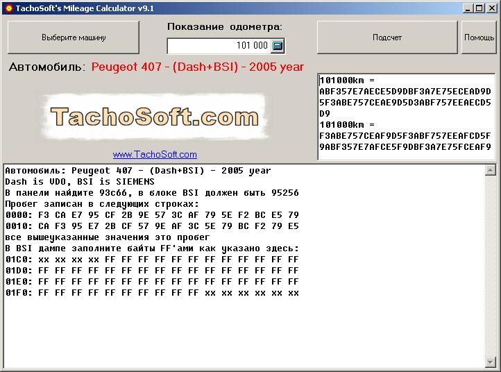

Surne by som potreboval na Peugeot 407 2004r.v. vypocitat km potrebujem tam 101 000km
Car type: Peugeot 407 - (Dash+BSI) - 2005 year
Dash is VDO, BSI is SIEMENS
Dash chip type is 93c66, in BSI you must find 95128
The mileage is stored in the next lines:
0000: F3 CA E7 95 CF 2B 9E 57 3C AF 79 5E F2 BC E5 79
0010: CA F3 95 E7 2B CF 57 9E AF 3C 5E 79 BC F2 79 E5
all shown bytes is a mileage
In the BSI put FF's as shown here:
01C0: xx xx xx xx FF FF FF FF FF FF FF FF FF FF FF FF
01D0: FF FF FF FF FF FF FF FF FF FF FF FF FF FF FF FF
01E0: FF FF FF FF FF FF FF FF FF FF FF FF FF FF FF FF
01F0: FF FF FF FF FF FF FF FF FF FF xx xx xx xx xx xx

Dakujem za vase rady... :) Obrázek

K O N I E C 407-ma beha
